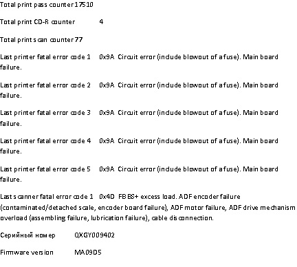

В printhelp снял отчет:
Total print pass counter 17510
Total print CD-R counter 4
Total print scan counter 77
Last printer fatal error code 1 0x9A Circuit error (include blowout of a fuse). Main board failure.
Last printer fatal error code 2 0x9A Circuit error (include blowout of a fuse). Main board failure.
Last printer fatal error code 3 0x9A Circuit error (include blowout of a fuse). Main board failure.
Last printer fatal error code 4 0x9A Circuit error (include blowout of a fuse). Main board failure.
Last printer fatal error code 5 0x9A Circuit error (include blowout of a fuse). Main board failure.
Last scanner fatal error code 1 0x4D FB BS+ excess load. ADF encoder failure (contaminated/detached scale, encoder board failure), ADF motor failure, ADF drive mechanism overload (assembling failure, lubrication failure), cable disconnection.
Серийный номер QXGY009402
Firmware version MA09D5
