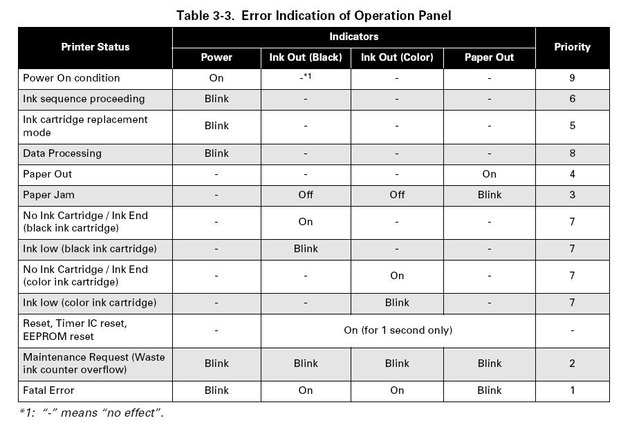

| Сообщение #5 Отправлено 25 июля 2011 - 13:00
На картинке индикация возможных ошибок. Текст, где много английских букв - возможные причины фатальной ошибки. Дерзайте !
1. Linear encoder FFC is disconnected from the sensor or liner encoder is
not attached to the carriage.
2. Linear encoder is dislocated.
3. ASF sensor is dislocated or ASF sensor connector is disconnected.
4. ASF sensor is defective or it fails to detect ASF home position.
5. PF encoder FFC is disconnected from the encoder sensor or the encoder
fails to read the slit pattern on the loop scale.
6. CR motor coil is discontinued or burnt.
7. PF motor coil is discontinued or /burnt.
8. ASF/Pump motor coil is discontinued or burnt.
9. Improper engagement of ASF gear (32) and the combination gear (14,
28) in the DE unit.
10.Torsion spring (0.618) has come off the DE lock lever or hook in the DE
unit.
28) in the DE unit.
unit.
